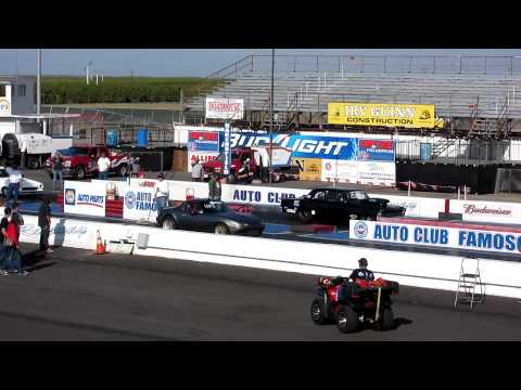

                      I'm still liking a jz mx5
                      Even when it goes wrong, no problem
                      http://www.youtube.com/watch?v=ww7oGKkrU-0
