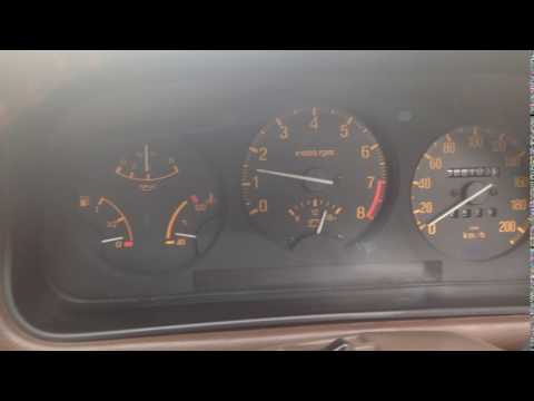

        yeah though to be fair nothing was wrong with the car when it was parked up 8 years ago so you'd hope nothing too serious had degraded. definitely glad i took the time to take the intake off etc and clean it out.
        it did blow some smoke the second time i started it up.
        Waiting on coolant pipes to refit all of the cooling system and then will see if it moves under it's own power (and stops).
        clutch master cylinder may need some work on top of the brakes.
        the pop up headlights make me unreasonably happy lol

                      i cobbled the cooling system back together to see if it can move under it's own power and.. yes! it stops pretty well too (still need to flush brake fluid though).
                      cooling system has some work to do (the bottom radiator hose, when it came off the car, took half the fitting off where it connects to the block. have used a top radiator hose as an interim solution since a lower one no longer reaches the reduced length fitting).
                      Mazcare has used a lot of my original hoses and lines to make up templates to help other people in the same boat as me, which is cool.
                      Filled up the coolant and ran it for a few minutes and the temperature stayed on the 1/4 mark on the gauge, no gas bubbles in the coolant, no steam out the exhaust. win.
                      Going to put some sort of coolant flush product in there and drain it all again in a day or two.
