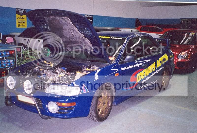

                I agree, they will shake around, and even something you have made up will still suffer from shake as most decent spotlights have a large diameter reflector. Nudge bars(designed like the blue car in the pic.) are perfect example.....terrible for light shake without support from the back of the light.
                Which ever way works best It will still also help to support them back from as high as possible on the rear(possibly through your grille) to alleviate the shake as much as possible.

                      photo of mine with turini's.... :D...
                      as MSL says, the stays to the bonnet are essential...
                      dunno how you'd manage that on WRX though..
                      Rowds
                        Twelve self tappers :D
                          yup, that'd work! thanks Muz, I can sleep now, knowing willsy's problem is solved.. :D
