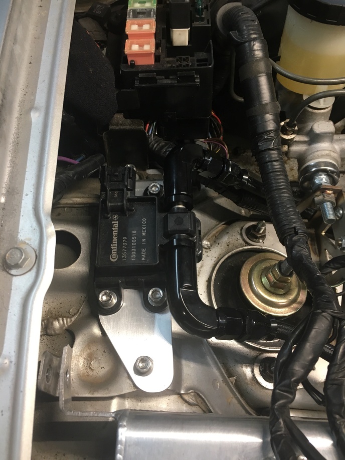

    Both are Continental sensors, but from memory the curve is slightly different between the GM style and the Ford style (named after the OEMs that tended to use them). The Haltech one is just a rebranded Continental sensor, part number here:
    Image linking seems broken: http://images.plebeians.net/_data/i/...631b676-xl.jpg

              Have a Syltech/Stubby Conti on mine. Works perfectly. It's smaller, shorter pipe too but doesn't have any easy mount points as OEM uses a plastic clip on thing. On Haltechs, make sure you have it as rising edge so temp works too.
