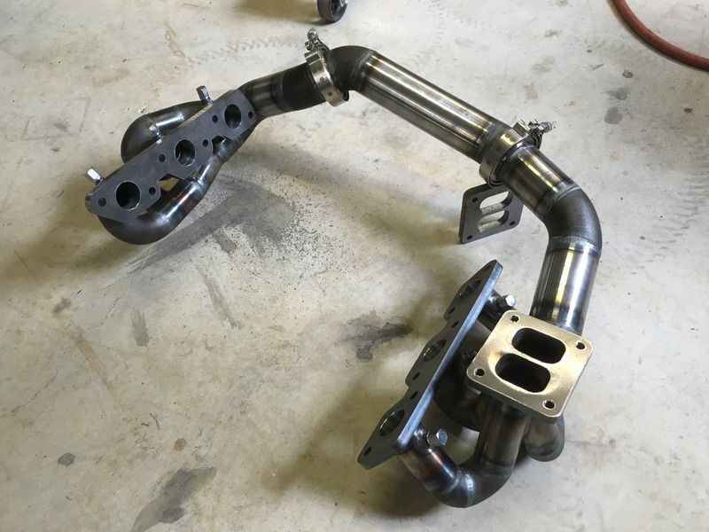

      Got talked into building another turbo manifold for an old customer. First manifold i have done in over 12 months i would say. I did notice i felt a bit rusty when starting it but starting to feel comfortable again.

                        Is it T3, T4 or T6? I made a lot more 1jz manifolds than 2jz.

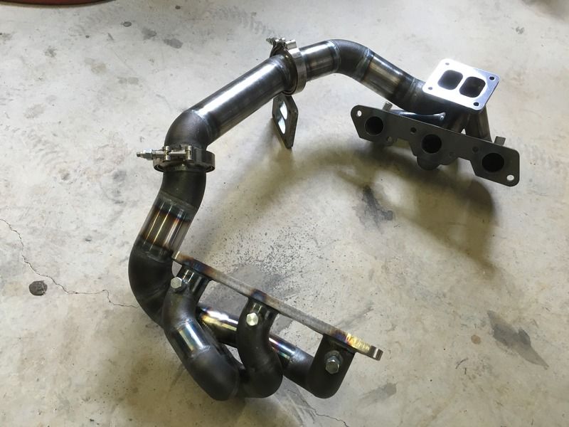

                              Moo manifold finished
                                ^ Very Nice.
