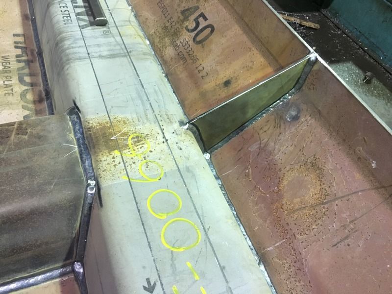

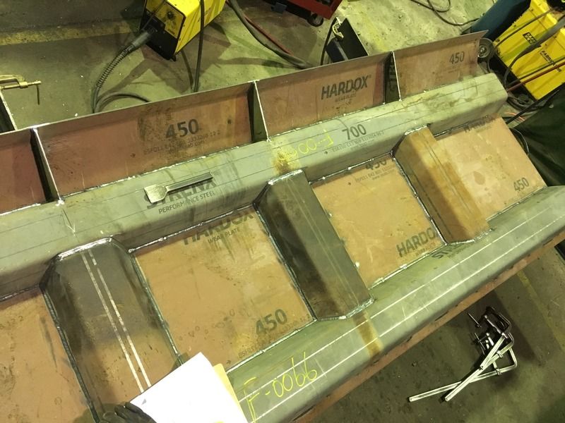

                        I have not done much of this but since there is short deadlines and mountains of work i pulled a light night and jumped on a welder after all the boys had gone home. FCAW. its hard to get a nice weld finish compared to solid wire but traveling up hill is very easy. Looks like shite but then knock the slag off and it doesnt look half bad.
