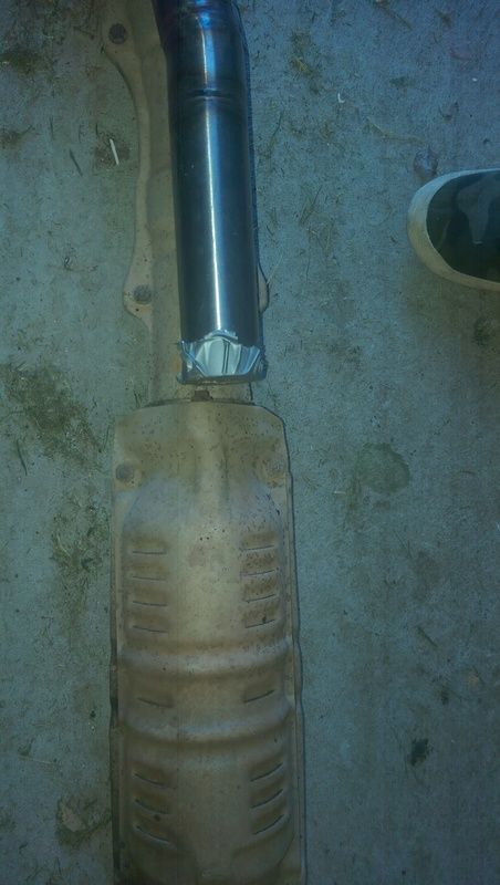

                  finally got around to working on the exhaust for my little honda. started this before i got sick. this is the first time ive felt confidant enough to try working under the car.
                  this is where i started...its 2 inch tube from work.
                  one end to the other...
                  tacked on the vband clamps...
                  purged her up... :D just in case lol
                  and wazzed away.
                  far from perfect, but im pretty happy for what amounts to the first real welding ive done since falling ill last year.
                  things were going great really. ran out of puff to finish the job, but got back to it today. and managed to bust my furick cup
                  soldiered on with a lot less pretty weld on the other end.
                  then set about working on the brackets and other half of the vbands... ran out of puff again.

                    Shit, looking good dude. Must feel nice to be back on the tools.
                      Yeah it's weird. On the one hand it feels awesome to get dirty again and make things again ... It really is a happy place kind of moment.
                      But it's tempered by the constant reminder of how far I am from being able to do "normal" stuff ... Sounds whingy I know, but yeah it's 50 50 lol
                      06/07/2011
                        Nah good work mate...neater beads thsn I'll ever lay down

                          Onya Pat. Run out of puff as many times as it takes, at least you're having a go.
                          Also, what Justen said.
                          Cheers, Richard
                          - Long Term Jobs
                            Nice work Pat, as above, far better than I can ever hope to do.

                              Fuck, you can drive a TIG good sir. Well done!

                                Don't know if I'm being overly critical or I'm getting a lot of sympathy props but everyone seems to be fairly complimentary lol. Maybe I just take good hidden pics lol.
                                Got enough go in me today to finish it all off and fit it up. I was about 15mm too short overall once it was all bolted up. More annoying than anything ... Makes bolting the muffler on a bit fiddly lol. But got to drive the Honda again and she doesn't sound too awful lol. Really proud to have been able to put together even sub a simple little project
