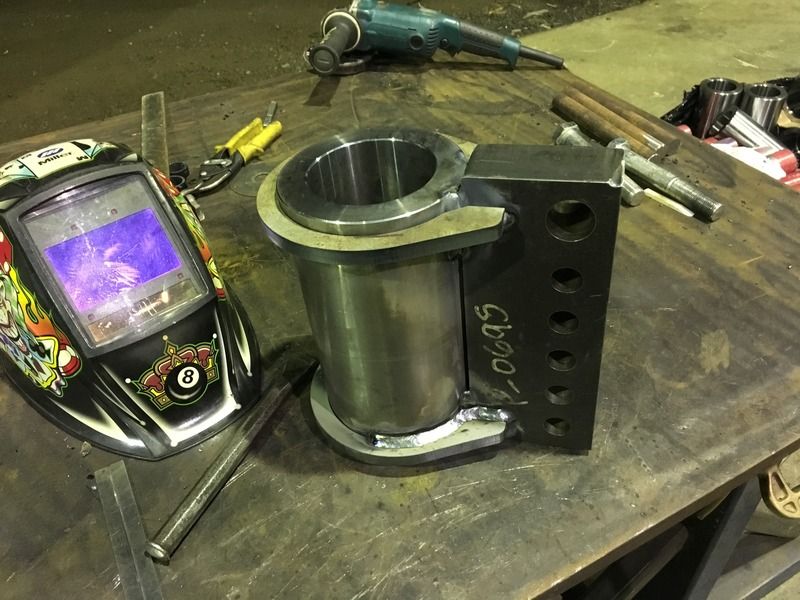

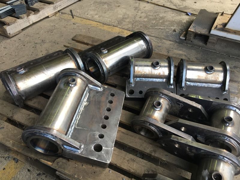

          I recently designed up some hitches for the earthmoving gear and all the plates and some machining was finished so I started putting them together.

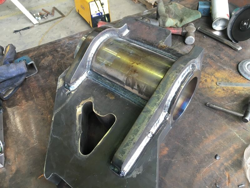

          And to try give some perspective on size:
