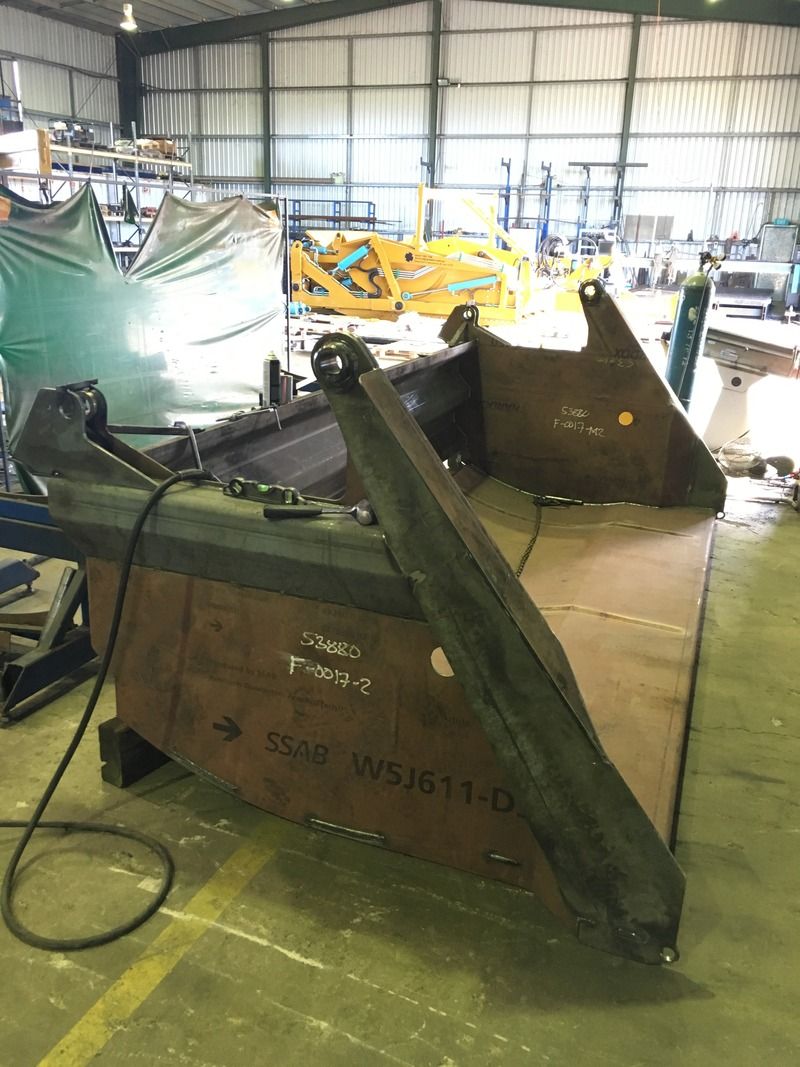

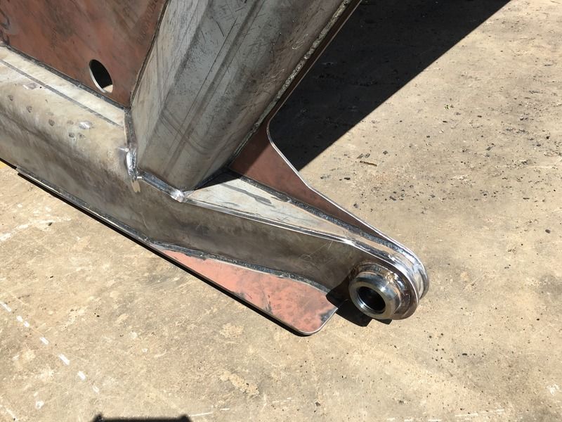

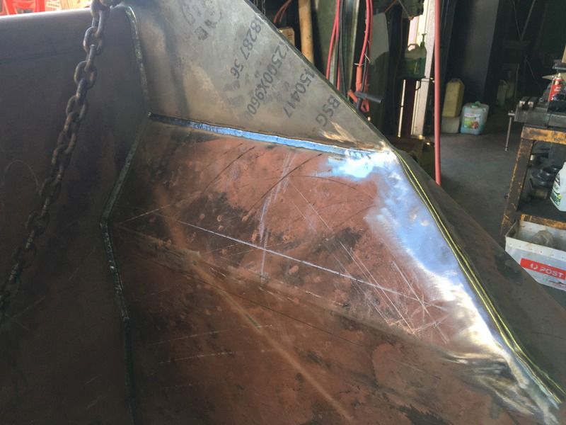

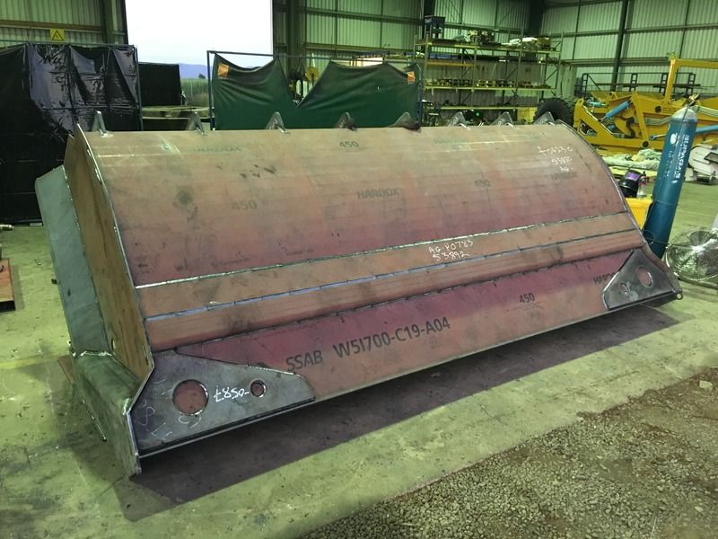

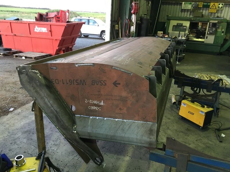

                    Did some welding this week:

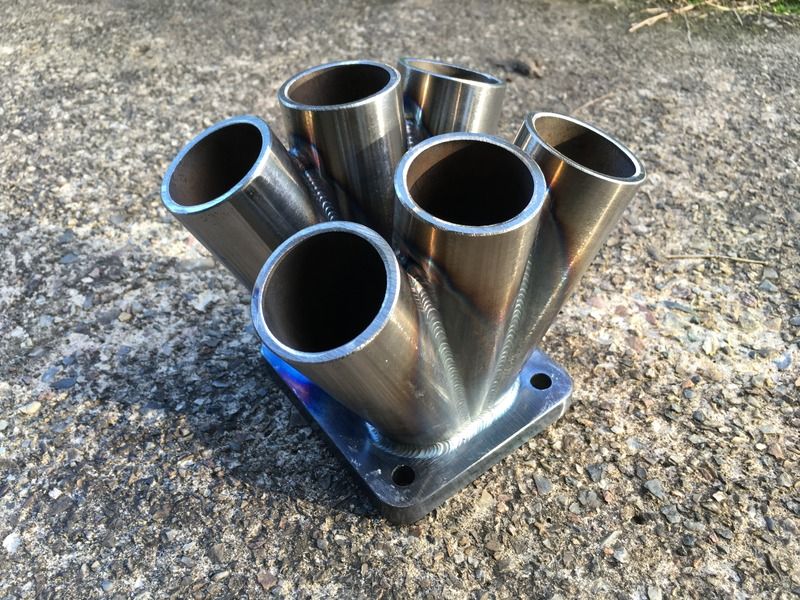

                    And made a collector this arvo
                    I still need to work on my out of position stuff.
                      Tidy!
                        Good old Hardox, the poor mans armour. 450 in 4mm is good for most handgun rounds up to .44 mag.
                          Remind me if I ever try to kill you to stab not shoot.
                            We are using 6mm Hardox. I like trimming a 4mm piece of the edge of some scrap and giving it to people to try bend with their hands. It blows their mind how strong it is.
                              6mm Hardox 500 will defeat AK-47 .
                                man I've fucked some drill bits drilling that shit and bisalloy
