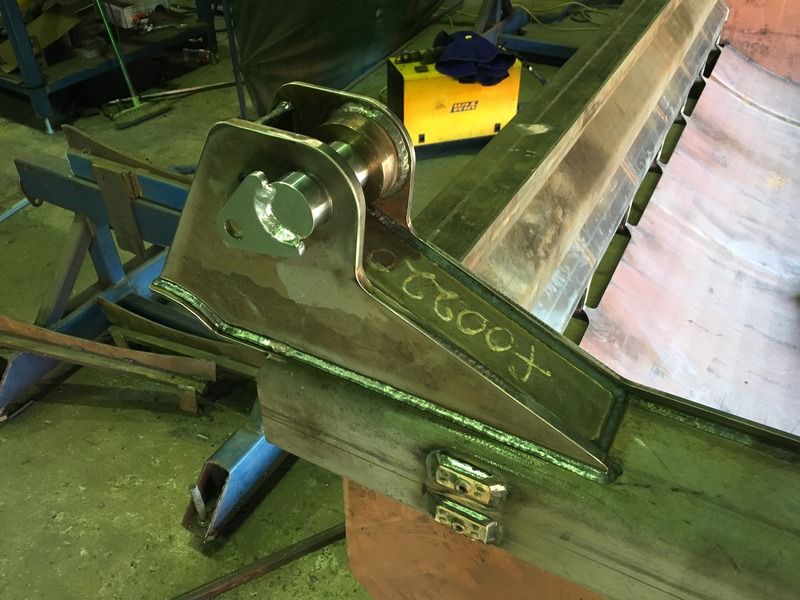

                  Enough chit chat. I did some more work on that fabrication today and took a photo:
