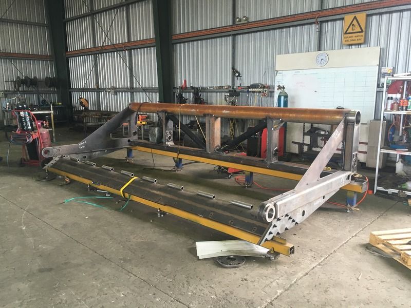

                                Some photos of the finished machine i posted photos of earlier on the page. I did most of the work on the rear frame section but not a real lot on anything else.
