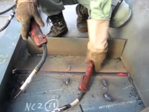

    We use flux core and the squiggly stuff is a big no no for that. Interviewed a bunch of blokes a few months back and one guy pushed the pool. When I said that's an interesting technique he was like oh ah yeah nah I have passed X-ray doing that before. I was like yeah righto.
    Personally I don't like the stop start look and would prefer a nice smooth bead. I think a smooth bead is harder to hide defects and faults. It's also harder to get nice and consistent.
    Are you suppose to drag? Sorry for the noob question
    Sent from my SM-G925I using Tapatalk
      Glad my swirllies caused such controversy lol.
      Pretty sure with flux core you treat it like stick and drag it along. Did watch a weld.com vid where they had a weld carriage thing push and pull a bead, same settings etc and in the end the difference in penetration was minimal.
        Yeah anything with flux and u need to drag. Pushing can get slag inclusions.
