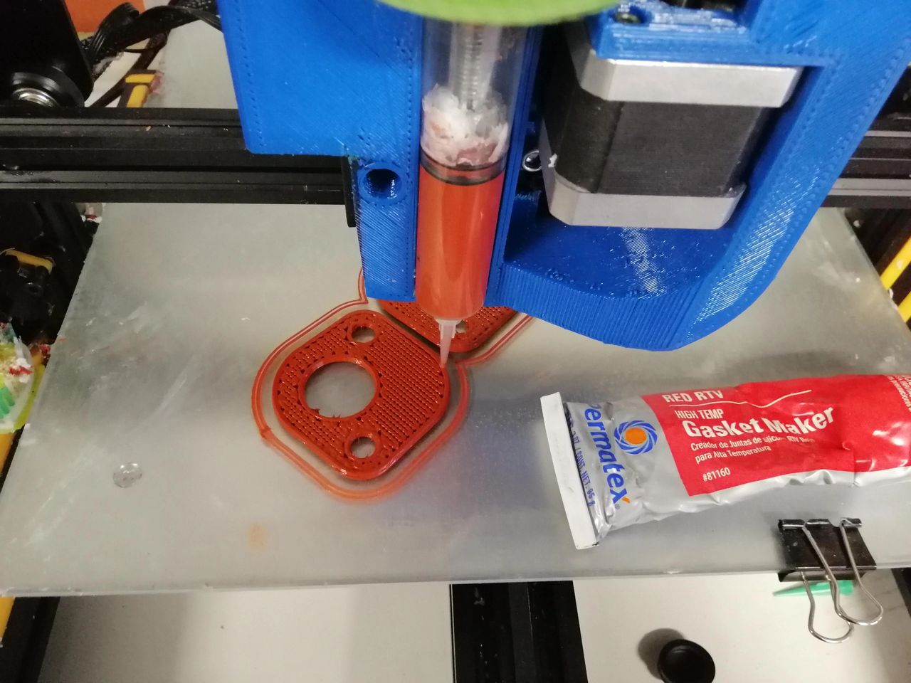

                        Originally posted by GSRman View Post
                        Oh - ended up with an ender 5+, 350x350x400 - won't do ABS without an enclosure - working on that -
                        also there's some firmware bugs.. so maybe wait if you want one.
                        Dude, WTF happened to your print bed?? Edward Scissor hands trying to remove prints??
                        I wouldn't recommend sex, drugs or insanity for everyone, but they've always worked for me...
                          Looks like a head crash and move.
                          The new nugget
                            Firmware fault - like a ghost in the Y limit switch - thinks it's gone all the way to the back, so drives as far forward as it can - and then raises the Z until the BL senses it - but at full forward the BL is off the bed... so it drives it up until it gets bored - and then starts printing... ran for 30+ mins while i was on my way to work like that.
                                Yeah wow, that sucks, I'm shocked at the gouges it took out of the print bed.
