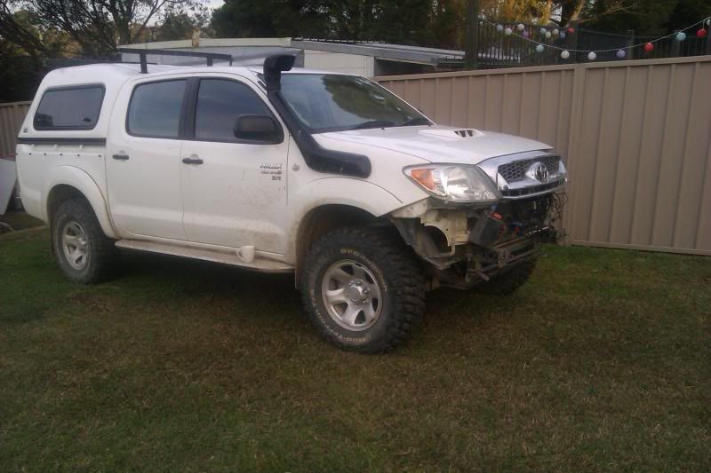

I made this today,as I needed to straighten the winch/bar mount I fucked over the weekend,pulling a little too hard (with the winch that is) up this fucking dirt hill with the diffs locked,the aldi winch at full tilt the cunt of a mountain beat me and the bulbar and the front 2 bash plates..........Cunt,ill be back next year to fuck you up.
Im going to the Cape in two weeks so no fucking around here,Im on limited time and $$$$$ had to think fast to straighten this cunt,it was bent and twisted. It pulled the bullbar forward about 2" and twisted the winch base and tried to twist the winch in half.
Its going to be re engineerd when i get back from the trip but for now this will have to do.
it looks naked without the bar on it,
so got the highlift out,half my home made bus drum fire and some steel packers and made a ghetto spec puller and then a few taps with sledge hammer,she's straight now back on the truck.
Better finish that press thats half done on the ground helping support things on the left. that wouldve shit this job in in 10mins. this took me abit to rig it up and was fucking dangerous. fuck yeh
