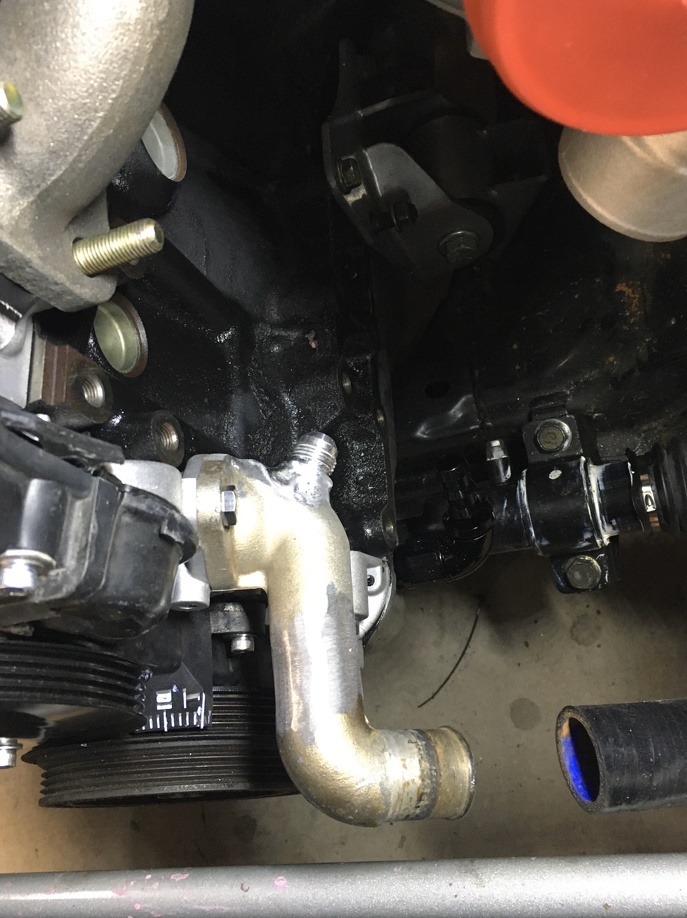

    Welded up some spare vac ports on the intake manifold etc, and am now left with some fairly unsightly linished bits, kind of like this on the water outlet:
    Short of painting the manifold, or linishing/brushing the entire thing, is there any reasonable way to make it look relatively factory?

    I would continue to remove the rough castings and then polish it, looks like it's a pretty small part with easy access.

      Nope, polishing is the last thing i want.

        Sandblast it.
          TK posted something years ago about 'restoring' a port finish to not looked like it had been ported (some sort of acid I think). Unfortunately I can't get the search to work to find it.
          Alternately, sand paper and a hammer?

            I thought the same thing, something about using battery acid (or some type of acid) to make a port look factory seem familiar??

              Yeah, i remember something too now that you mention it.
              A couple of other threads i have found mention muriatic acid as well.

                Maybe a needle scaler? may be too aggressive though

                  Too aggressive according to this thread:

                    Maybe orbital sand the whole thing with the roughest grit sandpaper you can get hold of.
                      Sand blast.
                        I've done this. Sandblasting will make that look oem in no time.

                          also done this with sand blasting alloy. looks sand cast and very acceptable. bear in mind, it gets dirt as fuck very quickly, so direct from the sandblaster (with gloves!) give it a quick hit with matt clearcoat

                            x3 Sandblasting, even in a small home cabinet setup gives it a dull non reflective surface.
                              I've found that hitting it with a stainless scouring pad knocks the sharp edges of a freshly blasted part and gets rid of the dirt magnet effect.
