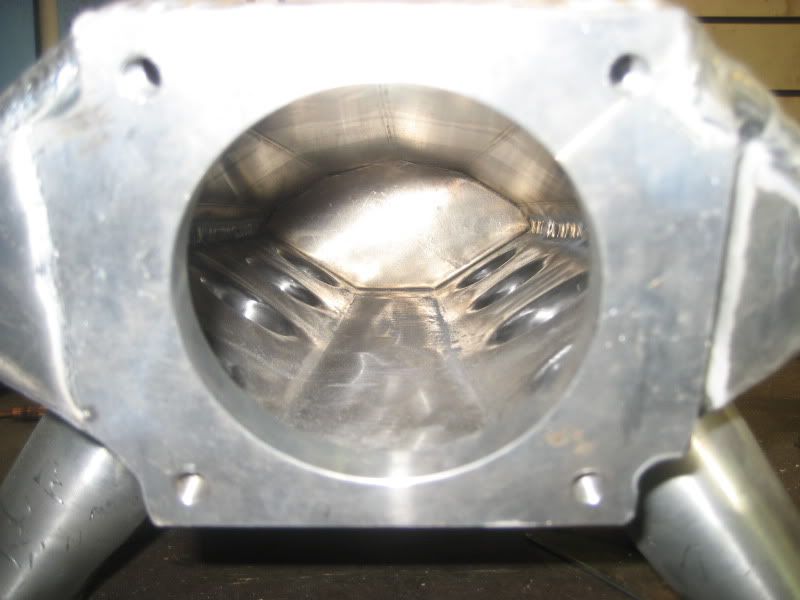

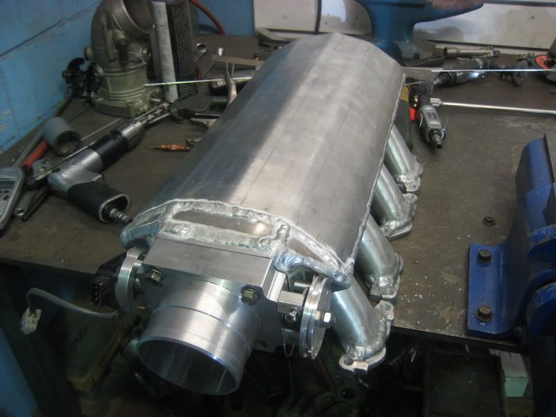

                    Did a bit to the manifold today, had a big week so it didn't get a look in till today.
                    Mounted the throttle body flange plate and plated in the gaps. The TB needs some minor mods to the linkage to allow it to operate freely(it's got some wacky chinese return spring on it that gives no fark for compactness) but it all fits otherwise. The flange is slightly offset from centre to allow the TB to fit next to the water outlet. Hardly noticable though.
                    Still haven't got my farking pedal that I paid for up front farking. Got a bit hot through some welds but I think I am getting a lot more aware of when it happens so once I get the pedal I will be able to control it then.
                    Had to replace the gas shroud seal and O ring on the torch after last weekend as they both melted and the rubber outer of the torch is all gooey too but still working. Can get a water cooled torch for $350, then just have to hook it up to a cooling system.

                          Can't quite put my finger on why, but that shot through the throttle body plate into the interior of the plenum makes me want to laugh.
