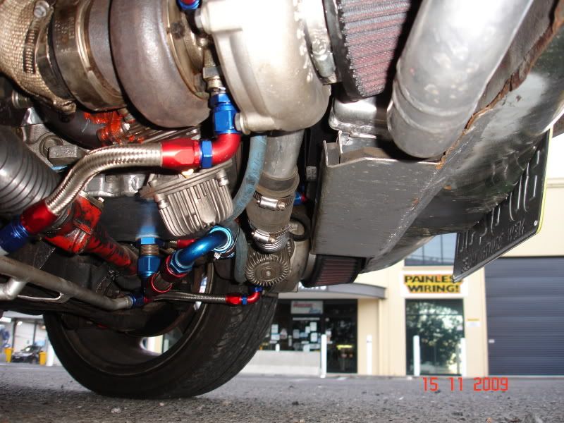

      I haven't finished it since I last posted this 30 minutes ago ->
      Yet to be run but I reckon it'll work all right.
        FWIW in an effort to make the car even more simple, lighter, and leak oil less, I've now gone to a WRX oil cooler.

              Anyhow I got a price from PWR for a liquide oil cooler Part # PWO5944 $540 + GST.
              The air type, 280x256x37mm is $310 + GST, the bloke said these two perform pretty much the same.
              Basically i explained its a VH41 twin turbo approx 500hp.
              I had pics of my Tory here somewhere.
                I mounted my Setrab oil cooler to the side of my PWR radiator and it gets vented air.

                    Locate oil cooler in driver's side of engine bay with ducting in and out = win?

                      thermostat for the oil cooler. you dont want cold oil flowing through the cooler. it takes longer to reach optimum engine temp (if you get there at all)
                      similar to jza80 tt factory oil cooler/warmer
                      this^^^

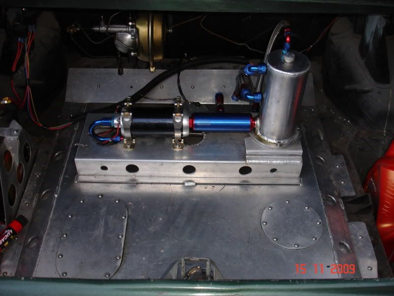

                        Can you put it in the boot? I am serious

                            the stock one isnt too good on hot days with extended hard driving.
                            plus getting rid of the factory one means you can get rid of all the coolant lines on the cold side of the engine (Iscv, and throttle are the other 2 things that has coolant fed to them that you dont need)
                            also if your trying to keep coolant temps down mount the oil cooler under the passenger headlight, not infront of the rad.

                                There all really good points guys, im kind of thinking liquide oil cooler, that would mean i can mount almost anywhere.
                                I will nut out the car this week, have another look at mounting position.
