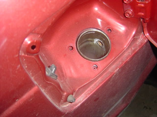

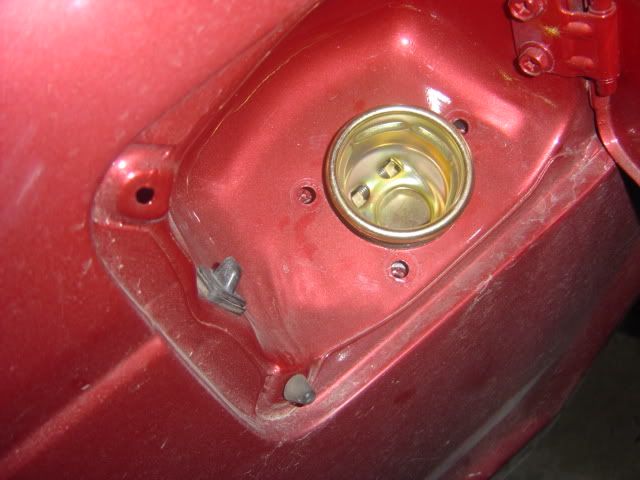

    I guess I have to fit a fuel neck restrictor as part of an engine conversion process. Question is, does such a thing exist as a purchaseable item or do I just get a random bit of tube welded in?
    I just bought the filler neck from something with a generic shape that suited. I found magna was spot on for my uses. I wrote "Unleaded fuel only" in texta inside the fuel flap and the engineer was happy with that too LOL

                            you can buy them, any compliance place will have them they cost about 10 bucks. I got mine from compliance components in andelaide, you die grind out the stock filler neck, use an expander to flare it a few mm then sikaflex in the new filler works real good.
